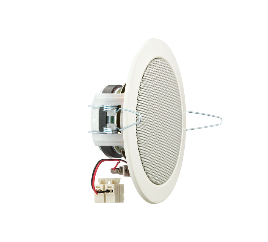

DL 10 - 8 Ohm
Art. No. 50110
10 cm (4") ceiling-mounted speaker with white metal cover (RAL 9010). Suitable for use in all types of hollow ceilings. Easy fitting in round cut-out using spring arms. A push-terminal block allows quick and easy connection. A compact solution for home and professional use with good sound qualities.
DL 10 can be supplied painted in other RAL colours on request.
Speaker cabinet systems for concrete ceilings are available from KAISER, 58579 Schalksmühle, Germany. The KompaX cabinet series is suitable for our ceiling speakers. Some additional front parts maybe necessary (front rings, mineral fibreboard etc.). More details are available on the Homepage of KAISER (Housing for lamps and loudspeakers). In order to get more detailed information, press the "Technical information" button of the particular product. Fire protection housing systems (F30) are also available (FlamoX). *) IP protection class for front side when built into a sealed enclosure

Technical Data
Sketch
Directivity pattern
Rated power 20 W
Maximum power 30 W
Nominal impedance Z 8 Ohm
Frequency response 75–20000 Hz
Mean sound pressure level 86 dB (1 W/1 m)
Opening angle (-6 dB) 82°/4000 Hz
Excursion limit +/−2.5 mm
Resonance frequency fs 140 Hz
Magnetic induction 0.7 T
Magnetic flux 130 µWb
Height of front pole-plate 4 mm
Voice coil diameter 20 mm
Height of winding 6 mm
Cutout diameter 110 mm
Net weight 0.4 kg
Sound pressure level 90 dB (1 W/1 m)@ 2100 Hz
Colour RAL 9010
Connections Spring terminals
Length of cable 0.1 m
Protective system IP 54 *)
Temperature range −40 ... 110 °C
