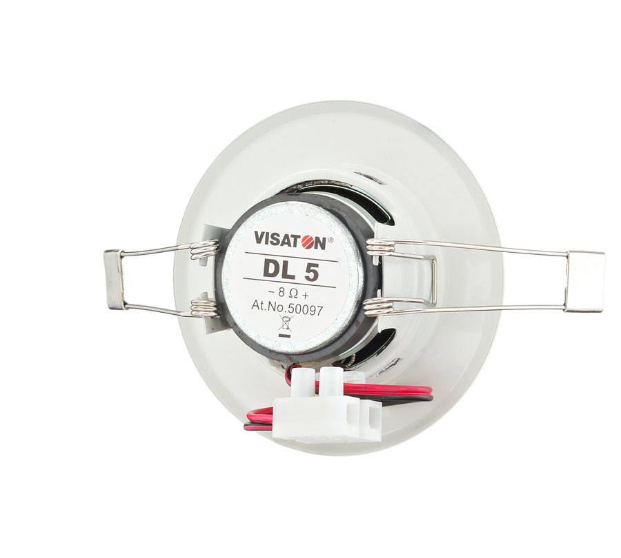

5 cm (2") ceiling speaker with white mounting frame (RAL 9010). Easy installation. Due to the special mounting frame ideal to combine with halogen light systems. Applicable for any non-spacious domestic- and professional sound systems. With additional transformer also suitable for 100 V-networks.
DL 5 can be supplied painted in other RAL colours on request.
Speaker cabinet systems for concrete ceilings are available from KAISER, 58579 Schalksmühle, Germany. The HaloX- and KompaX cabinet series are suitable for our ceiling speakers. Some additional front parts maybe necessary (front rings, mineral fibreboard etc.). More details are available on the Homepage of KAISER (Housing for lamps and loudspeakers). In order to get more detailed information, press the "Technical information" button of the particular product. Fire protection housing systems (F30) are also available (FlamoX). *) IP protection class for front side when built into a sealed enclosure

Rated power 4 W
Maximum power 10 W
Nominal impedance Z 8 Ohm
Frequency response 150–20000 Hz
Mean sound pressure level 84 dB (1 W/1 m)
Opening angle (-6 dB) 123°/4000 Hz
Resonance frequency fs 300 Hz
Magnetic induction 0.69 T
Magnetic flux 91 µWb
Voice coil diameter 14 mm
Height of winding 3.5 mm
Cutout diameter 72 mm
Net weight 0.16 kg
Sound pressure level 89 dB (1 W/1 m)@ 4018 Hz
Colour RAL 9010
Connections Screw terminals
Length of cable 0.14 m
Protective system IP 54 *)
Temperature range −40 ... 110 °C
