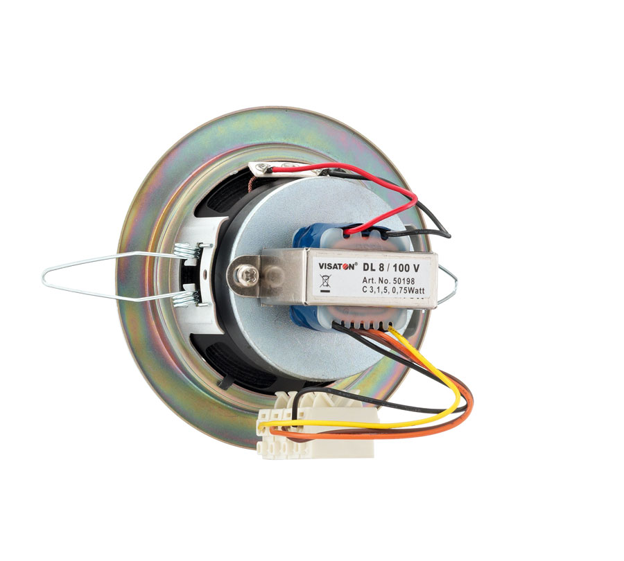

8 cm (3.3") ceiling-mounted speaker with white metal cover (RAL 9010). Suitable for use in all types of hollow ceilings. Easy fitting in round cut-out using spring arms, electrical connection by spring-loaded terminal clips. A compact solution for home and professional use with good sound qualities. Smaller voice coil enlarges the sound pressure level.
DL 8 can be supplied painted in other RAL colours on request.
Speaker cabinet systems for concrete ceilings are available from KAISER, 58579 Schalksmühle, Germany. The KompaX cabinet series is suitable for our ceiling speakers. Some additional front parts maybe necessary (front rings, mineral fibreboard etc.). More details are available on the Homepage of KAISER (Housing for lamps and loudspeakers). In order to get more detailed information, press the "Technical information" button of the particular product. Fire protection housing systems (F30) are also available (FlamoX).

  • For fitting in hollow ceilings, for music and speech in shops, at home, hotels etc.
Attributes
  • Moisture-resistant membrane
  • UV-resistant
  • Meatal basket, non-corrodible
  • Functionally at low temperature according to EN 60068-2-1 (-40 °C; 96 h)
  • Up to the standards of the Germanischer Lloyd (requirements for electrical equipment/low temperature)
  • Ball-resistant
  • 100 V transformer

Nominal impedance Z 8 Ohm
Frequency response 90–18000 Hz
Mean sound pressure level 87 dB (1 W/1 m)
Opening angle (-6 dB) 112°/4000 Hz
Height of front pole-plate 3 mm
Voice coil diameter 14 mm
Cutout diameter 93 mm
Net weight 0.515 kg
Transformer matching 3 W/1.5 W/0.75 W
Sound pressure level 90 dB (1 W/1 m)@ 3600 Hz
Max. sound pressure level 91 dB (3 W/1 m)
Colour RAL 9010
Connections Spring terminals
Length of cable 0.15 m
Protective system IP 54 *)
Temperature range −40 ... 110 °C
