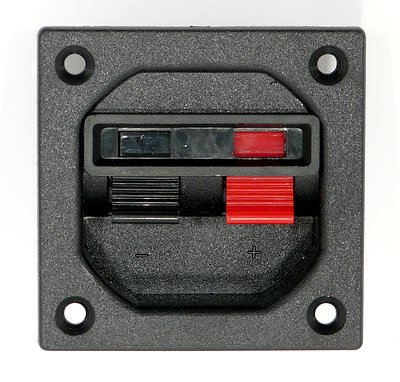

PT 57 NG
Art. No. 5192
Loudspeaker terminal with recessed terminal board and foam sealing for airtight installation. For cable diameters of up to 10 mm2, 2-pole, 1 red and 1 black lever each. Round mounting cutout. Including mounting screws.
