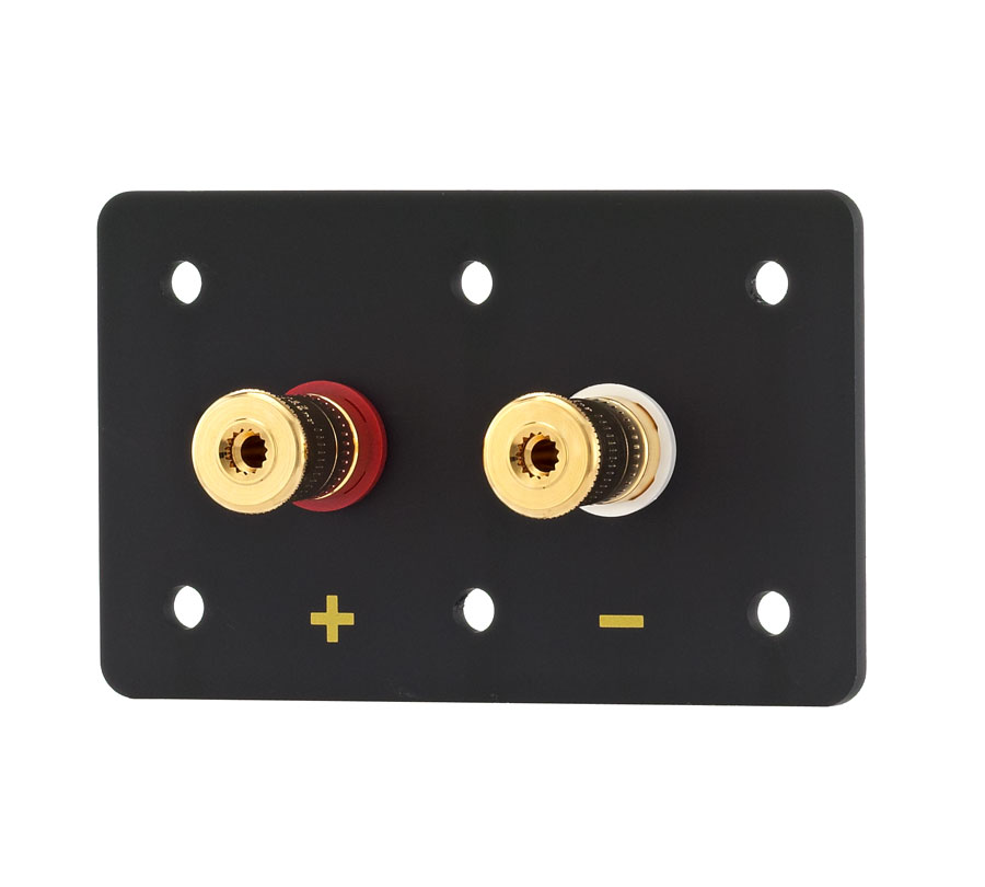

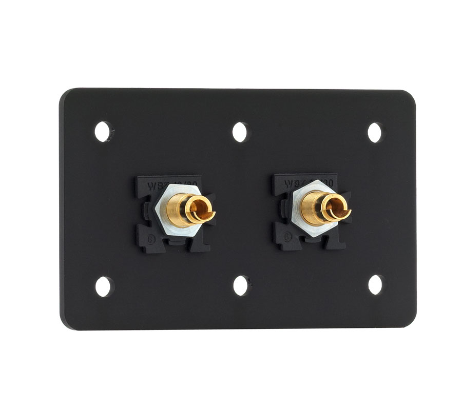

HIGH-END-TERMINAL
Art. No. 5195
High-End-Terminal with rigid mounting plate, 5-Layer Supra Gold Plated WBT binding posts and freely revolving pressing part. For connection cables with cross sections between 1.5 and 10 square millimetres to guarantee a proper contact for peak currents up to 200 A.
