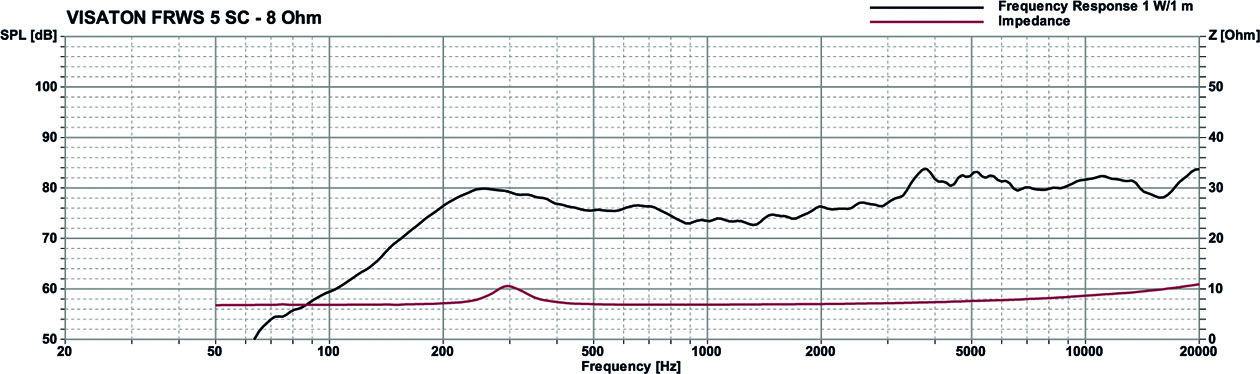

Technical Data
Sketch

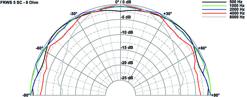

Directivity pattern
Rated power 4 W
Maximum power 8 W
Nominal impedance Z 8 Ohm
Frequency response 200–20000 Hz
Mean sound pressure level 80 dB (1 W/1 m)
Opening angle (-6 dB) 180°/4000 Hz
Excursion limit +/−2 mm
Resonance frequency fs 350 Hz
Voice coil diameter 14 mm
Height of winding 3.5 mm
Cutout diameter 45 mm
Net weight 0.052 kg
D.C. resistance Rdc 7.2 Ohm
Mechanical Q factor Qms 4.1
Electrical Q factor Qes 9.35
Total Q factor Qts 2.85
Equivalent volume Vas 0.2 l
Effective piston area Sd 12 cm²
Dynamically moved mass Mms 0.5 g
Force factor Bxl 1 Tm
Inductance of the voice coil L 0.1 mH
Connections Solder lugs
Temperature range –25 ... 70 °C
