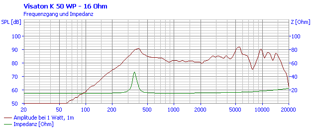

Sketch
Directivity pattern
Rated power 2 W
Maximum power 3 W
Nominal impedance Z 16 Ohm
Frequency response 180–17000 Hz
Mean sound pressure level 84 dB (1 W/1 m)
Opening angle (-6 dB) 180°/4000 Hz
Excursion limit +/−1 mm
Resonance frequency fs 300 Hz
Height of front pole-plate 2 mm
Voice coil diameter 10 mm
Height of winding 2.5 mm
Cutout diameter 46 mm
Net weight 0.048 kg
Connections 2.8 x 0.5 mm (+)/2.8 x 0.5 mm (-)
Protective system IP 65 *)
Temperature range −40 ... 80 °C
