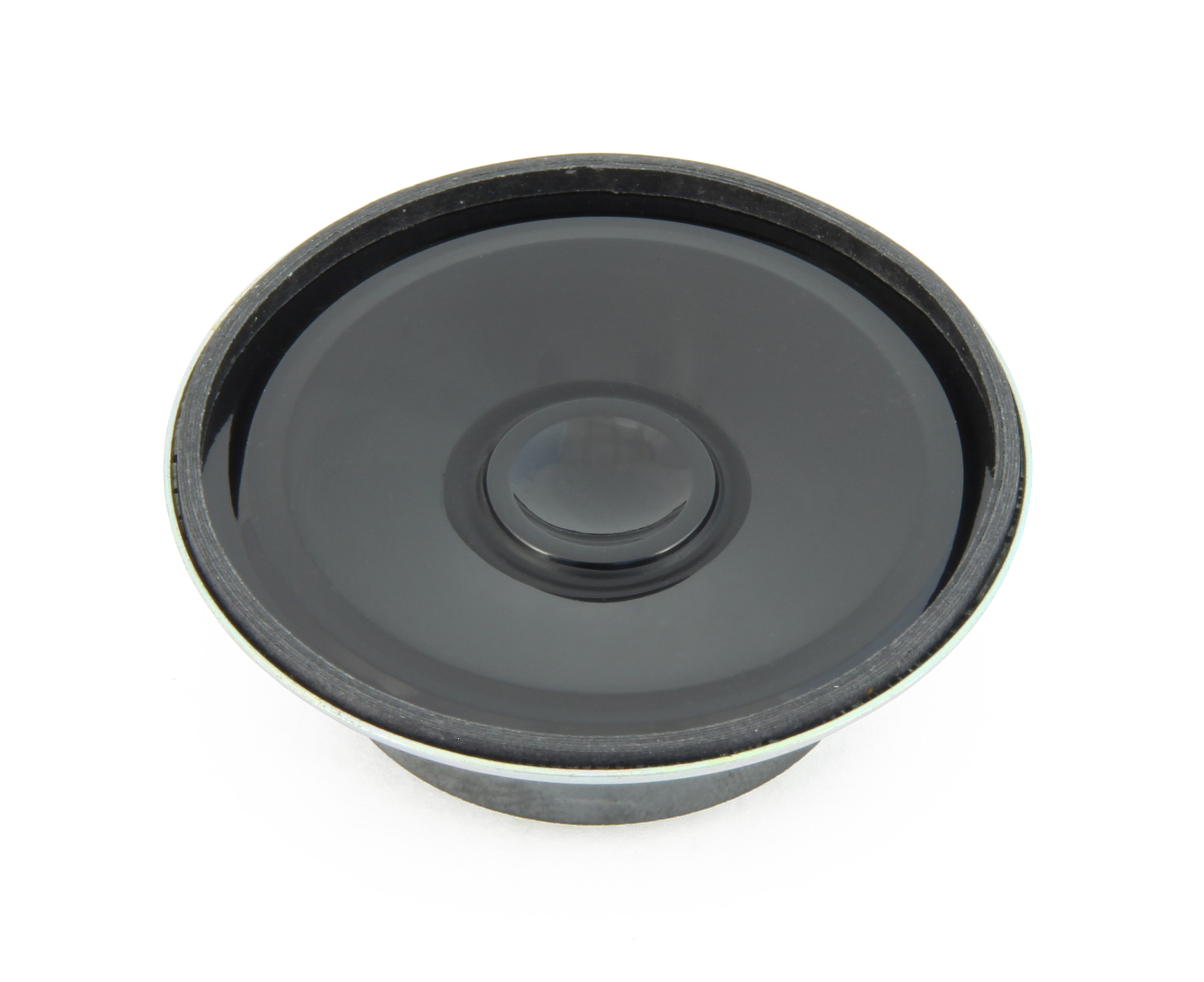

5 cm (2") miniature speaker with plastic diaphragm and metal basket. Thanks to its compact dimensions, suitable for signal output in machines and other equipment where space is at a premium. *) IP protection class for front side when built into a sealed enclosure

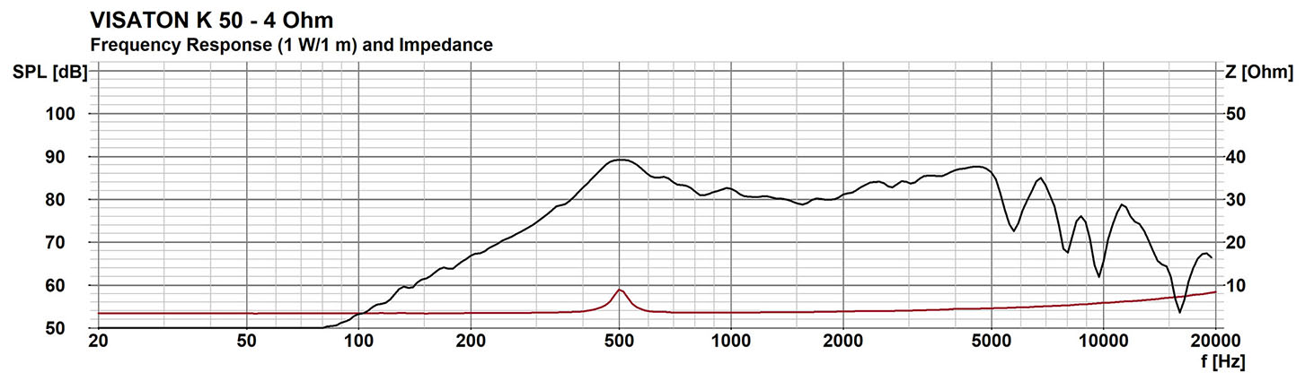

Frequency response 250–10000 Hz
Mean sound pressure level 83 dB (1 W/1 m)
Opening angle (-6 dB) 180°/4000 Hz
Excursion limit +/−0.5 mm
Resonance frequency fs 500 Hz

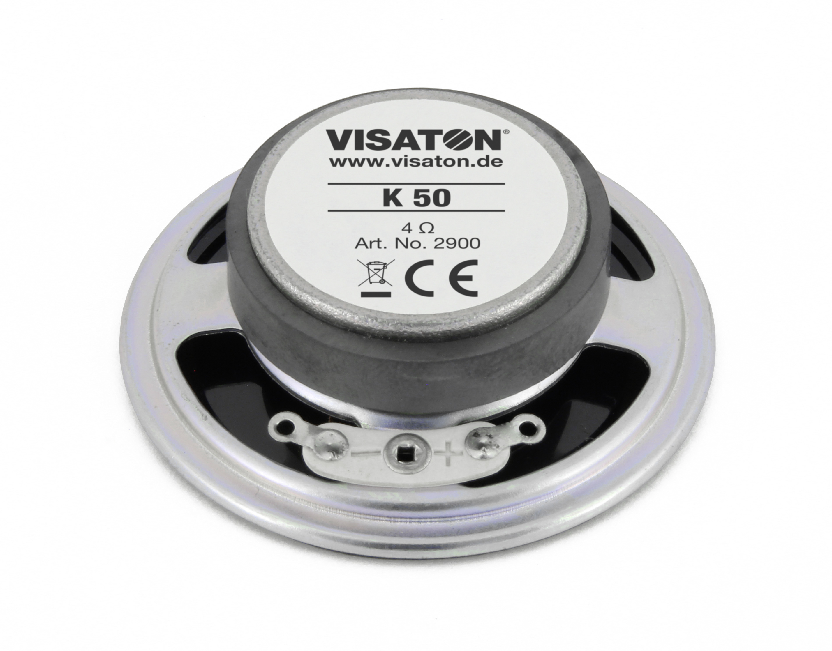

Connections Solder lugs
Protective system IP 65 *)
