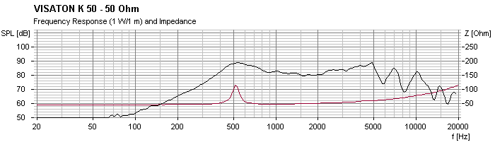

Technical Data
Sketch
Directivity pattern
Rated power 2 W
Nominal impedance Z 50 Ohm
Frequency response 250–10000 Hz
Mean sound pressure level 83 dB (1 W/1 m)
Opening angle (-6 dB) 180°/4000 Hz
Excursion limit +/−0.5 mm
Resonance frequency fs 500 Hz
Height of front pole-plate 2 mm
Voice coil diameter 14 mm
Height of winding 3 mm
Cutout diameter 45 mm
Net weight 0.05 kg
Connections Solder lugs
Protective system IP 65 *)
Temperature range −40 ... 70 °C
